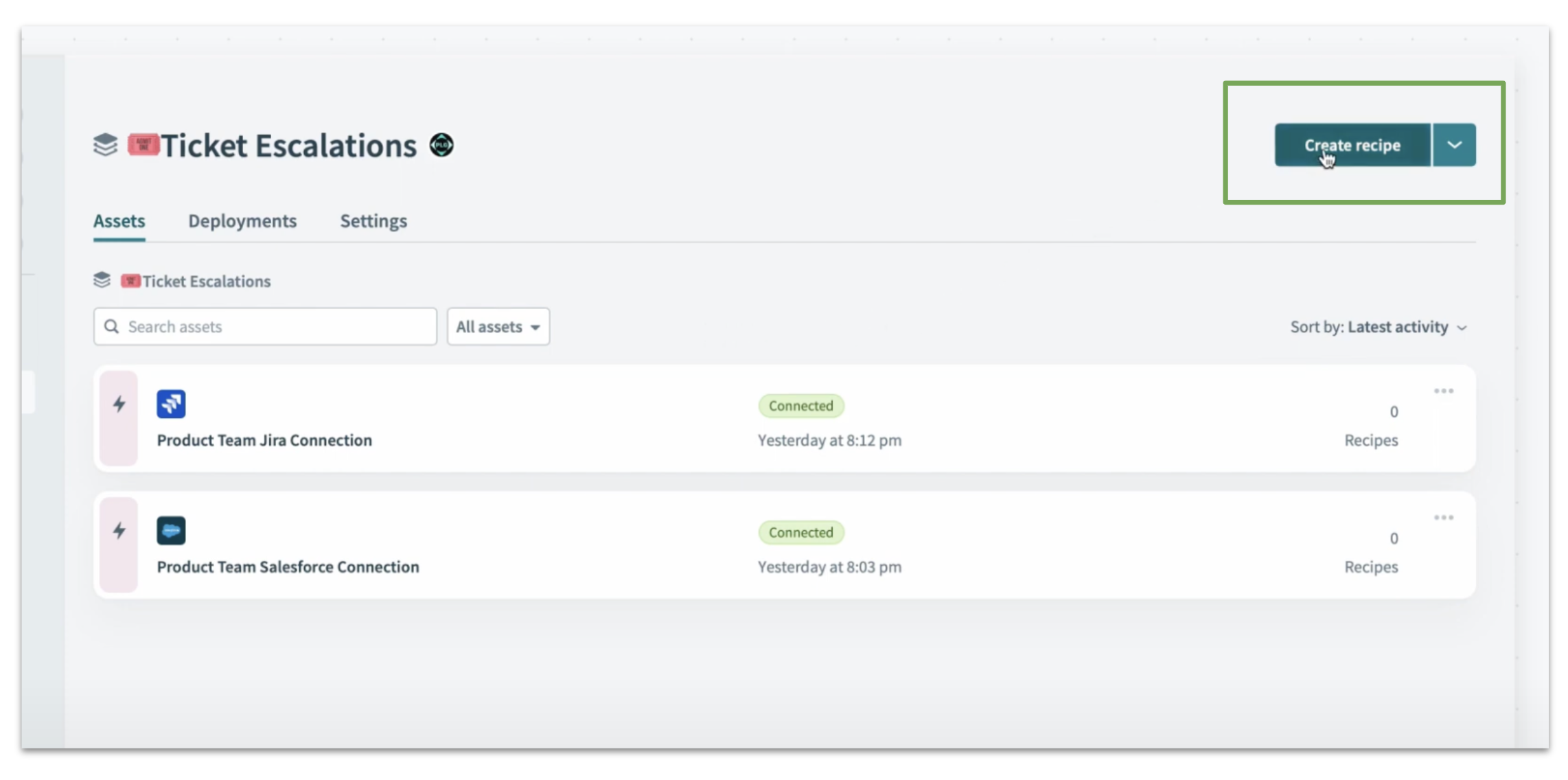

Step 1: Open a new recipe
In your workspace, navigate to the project where you would like to build your recipe. In this case, I will be building this recipe in the Ticket Escalations
project.
For this example, the admin has already created app connections for JIRA and Salesforce — the two business apps we will be automating for this recipe.
To start building your recipe, click the Create Recipe
button at the top right-hand corner of your screen.

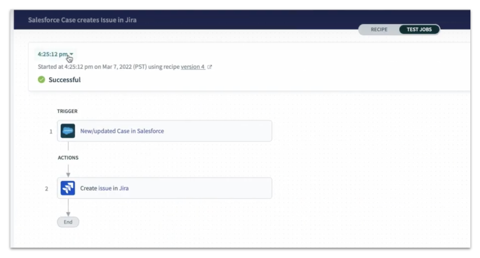

Step 4: Test your recipe
Lastly, it’s time to test your recipe. First, save your recipe by clicking the Save
button at the top right hand corner of the recipe editor.
For this demonstration, I went to Salesforce and created a new Salesforce case. If the recipe works, a new issue should be created in Jira automatically.
To test your recipe, simply click on the Test Recipe
button right next to the Save
button to start your recipe.
Test your recipe
After running the trigger, I can see that the job was successful.
Let’s go to Jira and check if it created a new issue. It did!
